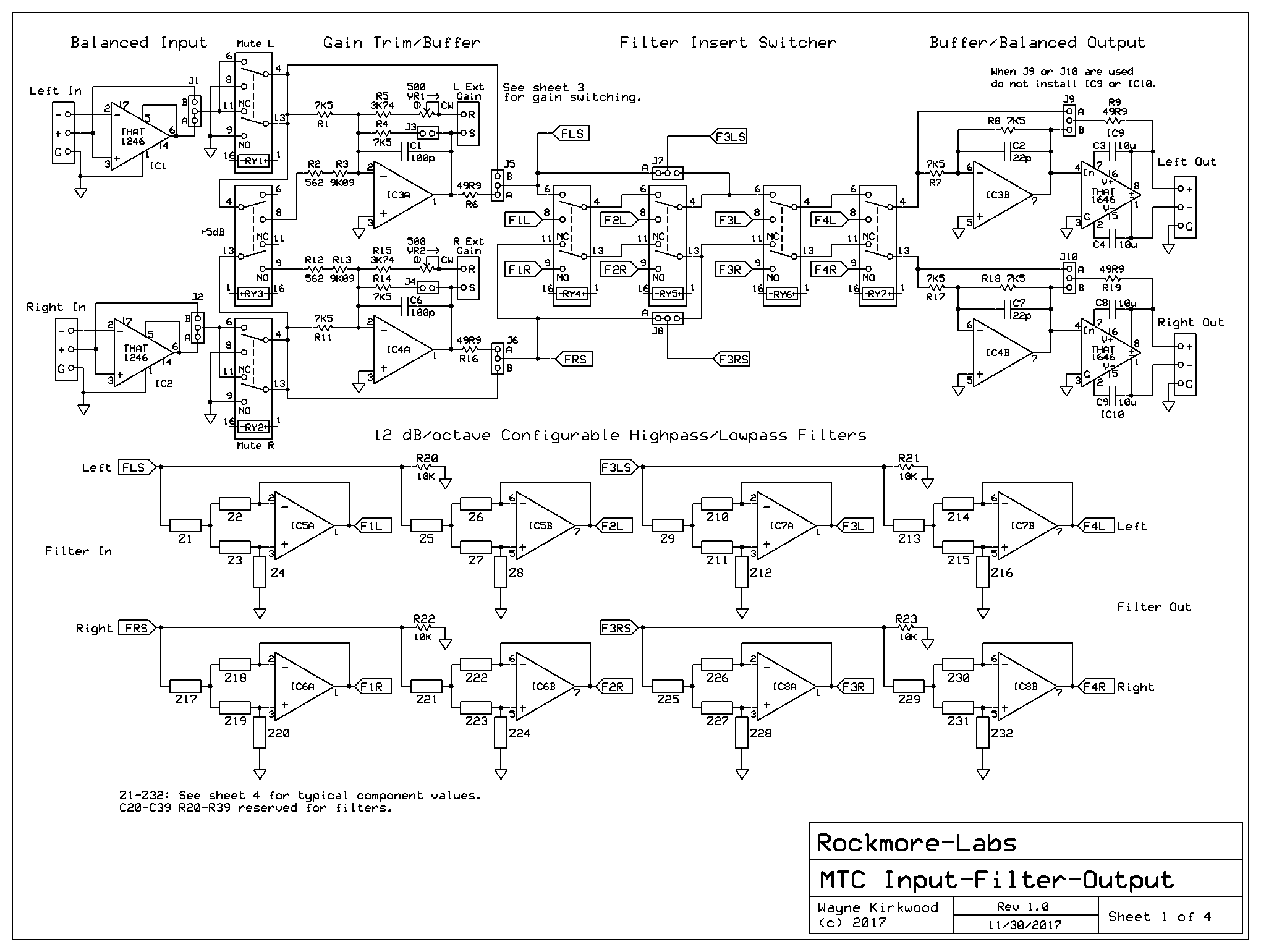

Schematics
![Image](http://www.ka-electronics.com/images/png/MTC_Input_Filter_Output_Sheet_1_800_BW.png)
Mastering Transfer Console Input, Filter, Output Stages.
Large format schematic: http://www.ka-electronics.com/images/png/MTC_Input_Filter_Output_Sheet_1.png
Circuit Description
Balanced Input and Gain
A THAT1246 provides balanced inputs.
Relays RY1 and RY2 provide individual Mutes for the Left and Right Inputs.
IC3A and IC4A are a variable or fixed gain stage.
RY3 increases the Left and Right Gain by +5 dB.
When J3 is linked IC3A has a gain of -1. (External gain open.)
An external variable resistance, 0-10KΩ, varies the gain of IC3A from -5.5 dB to +5.5 dB.
VR1 calibrates the lowest gain step to exactly -5.5 dB.
J1 bypasses the THAT1246 input for board cascading or unbalanced input.
J5 bypasses IC3A.
J1, the Mute relay NC contacts and J5 link the input connector directly to the filter insert switcher for board cascading.
Filter Insert Switcher
The filter inputs are driven in parallel by IC3A/IC4A with the option of the last two filters being cascaded from the output of the first two.
When J7 is in the A position all four filters are fed in parallel.
Placing J7 in the B position allows cascading the second two filters to the output of the first two.
An example of cascading would be to have the first pair configured as HP filters and the second pair as LP filters.
This would provide HP filters of 20 and 40 Hz and/or LP filters of 14 or 18 kHz.
The A position is used when two boards are cascaded and more than four filters are required.
The B position is used for a single board providing four filters.
RY4-RY7 are an insert switcher that select which filter output appears in the chain.
When no filters are selected the insert provides hard wire bypass.
IC3B/IC4B are a unity gain inverting stage to supply a "0Ω" source impedance to the THAT1646 balanced output.
IC3B/IC4B also correct for the polarity inversion of IC3A/IC4A.
J9 in the A position allows the filter insert switcher output to cascade directly into a second board.
J9B lets IC3B/IC4B drive the output directly.
When J9 is used the THAT1646 should not be installed.
A THAT1646 on the final board provides a balanced output to drive the transfer system's insert chain.
Configurable Filters
The MTC filters are standard unity gain Sallen-Key filter blocks.
Because the filter blocks can be either high or low pass, impedances (Z1-Z32) are used to represent resistor and capacitor component locations.
The filters are configured as high pass or low pass depending on where the PC board's components are loaded.
Tuning component locations on the PC board accept 5mm Wima film caps or 1/4W resistors to allow a common layout to be a low or high pass filter.
Schematic sheet 4 illustrates the transformation from high to low pass by swapping the locations of Rs and Cs.
Resistors R20-R23 provide an op amp input bias current path for low pass filter configurations during relay switching.

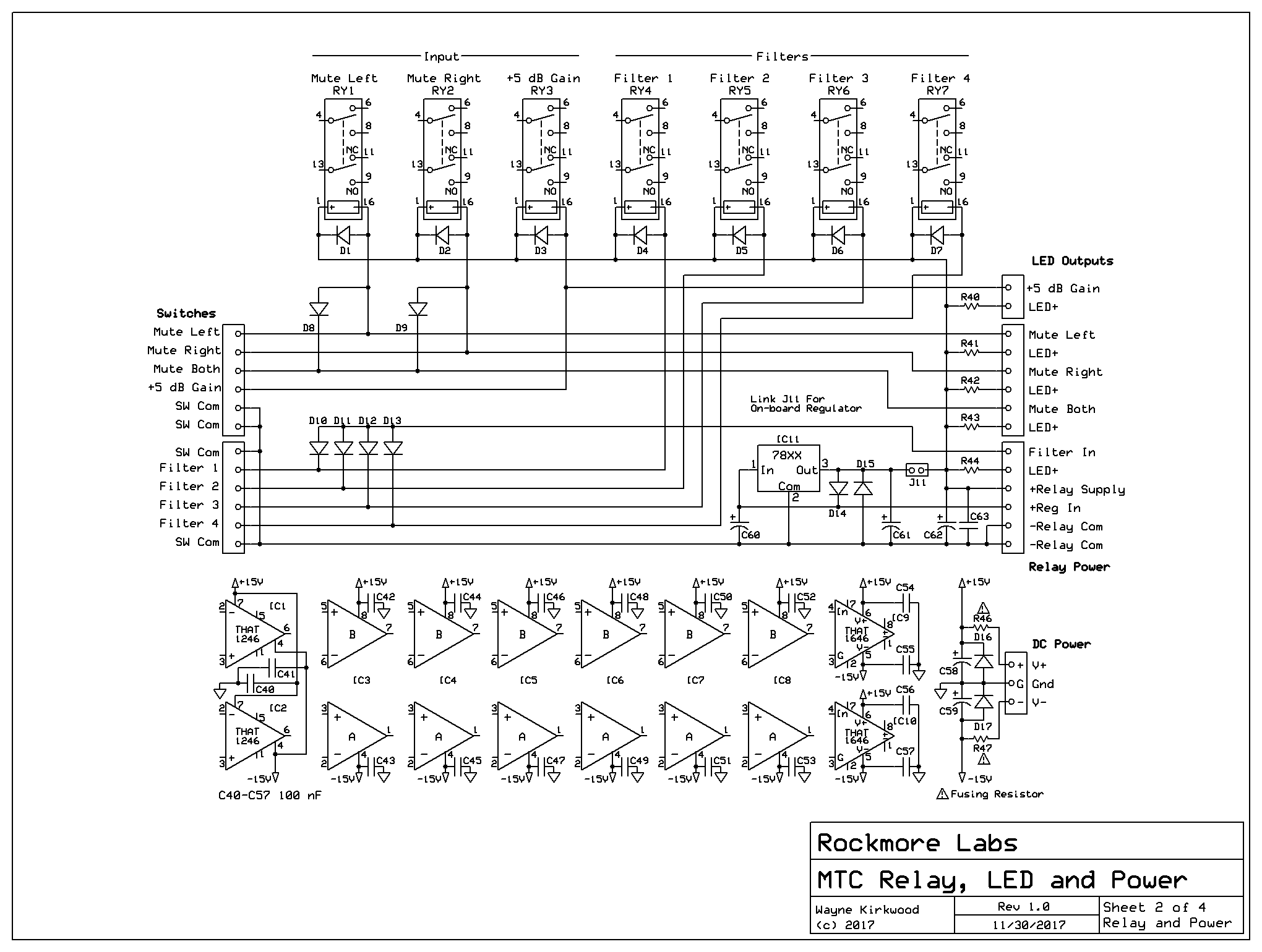

Relay, LED and Power Distribution
![Image](http://www.ka-electronics.com/images/png/MTC_Relay_LED_Power_Sheet_2_800_BW.png)
Mastering Transfer Console Relay, LED and Power Distribution.
Large format schematic: http://www.ka-electronics.com/images/png/MTC_Relay_LED_Power_Sheet_2.png
The relay coil common is isolated from audio ground and has its own optional regulator.
RY1/RY2 are the individual Left and Right Mute relays.
D8 and D9 allow Stereo Mute capability with a single contact closure.
RY3 is the +5 dB Gain relay.
RY1-RY3 also have current-limited LED tally outputs for switch illumination.
RY4-RY7 are the filter insert relays.
Diodes D10-D13 provide a current-limited LED output when any filter is engaged.

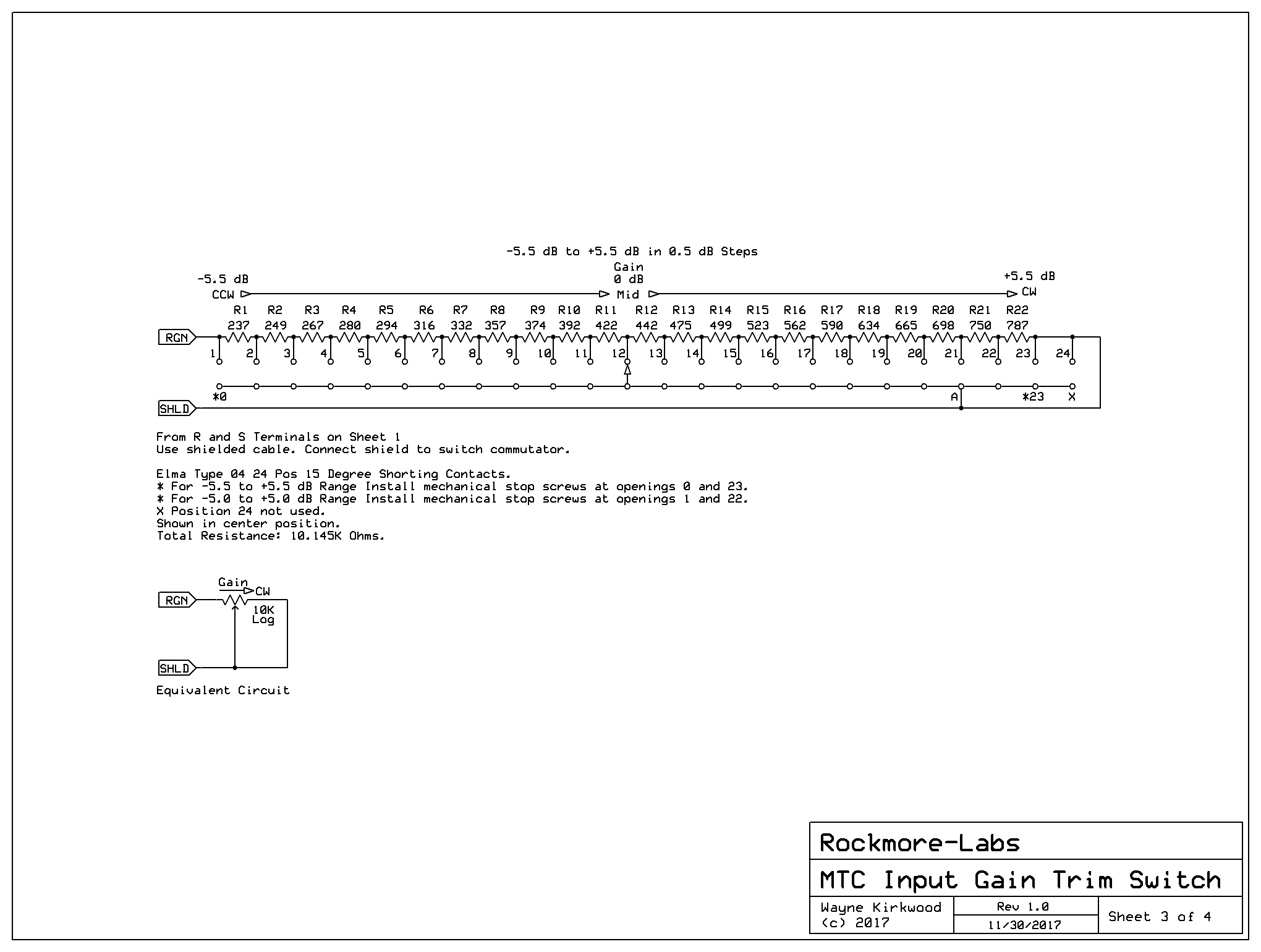

Gain Switch
![Image](http://www.ka-electronics.com/images/png/MTC_Gain_Switch_Sheet_3_800_BW.png)
Mastering Transfer Console Gain Switch Detail.
Large format schematic: http://www.ka-electronics.com/images/png/MTC_Gain_Switch_Sheet_3.png
The gain switch is designed around the 24 position Elma Type 04 15° shorting rotary switch.
Note that the cable shield to the switch is driven by IC3A/IC4A's output.
The driven shield makes the shield-to-center-conductor capacitance of the cable beneficial to the circuit because it is in parallel with the feedback resistance.

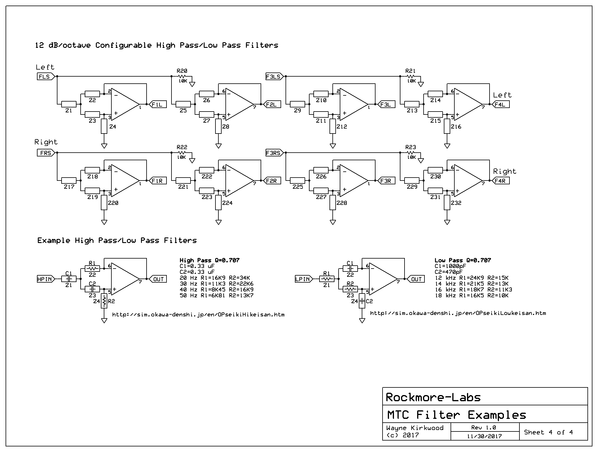

![Image](http://www.ka-electronics.com/images/png/MTC_Filter_Examples_Sheet_4_800_BW.png)
Mastering Transfer Console Configurable Filter Examples.
Large format schematic: http://www.ka-electronics.com/images/png/MTC_Filter_Examples_Sheet_4.png

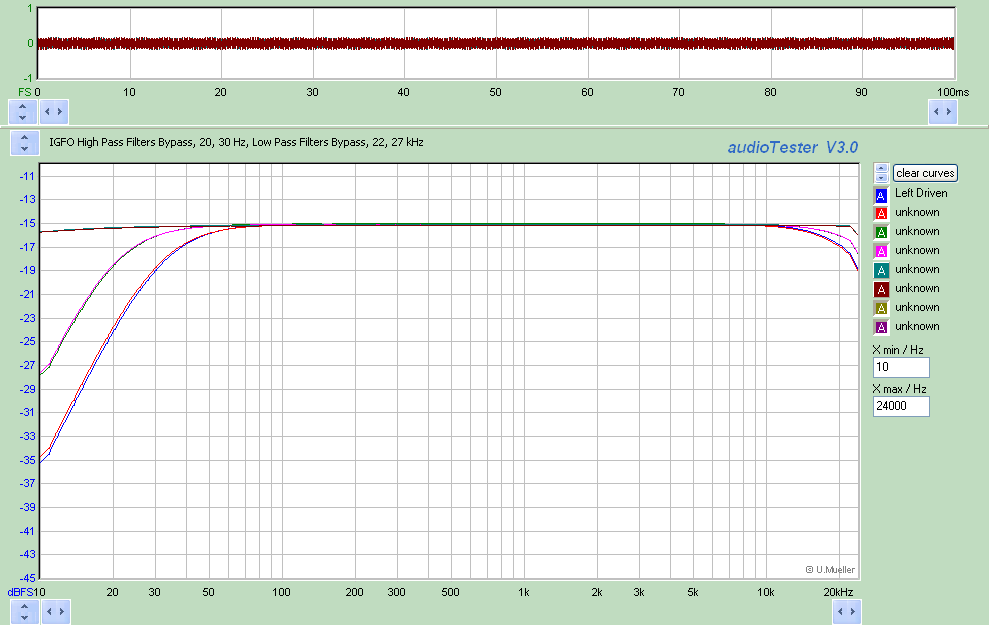

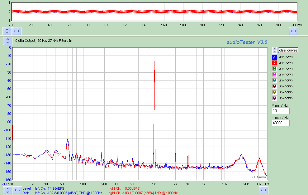

This is the filter response for the IGFO board built for 20, 30 Hz HPF and 22, 27 kHz LPF.
The DAC used to plot this has 22 kHz output filters (despite its 96 kHz sample rate) so above 22 K the steep roll off seen with the filters bypassed is not real.

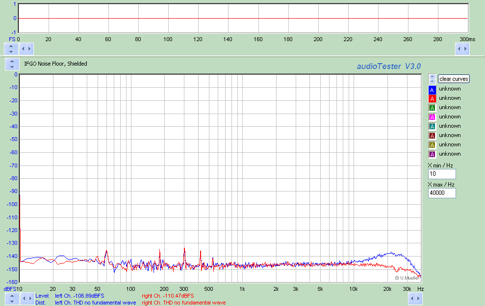

![Image](http://www.ka-electronics.com/images/png/IGFO_FFT.png)
![Image](http://www.ka-electronics.com/images/png/IGFO_Noise.png)
