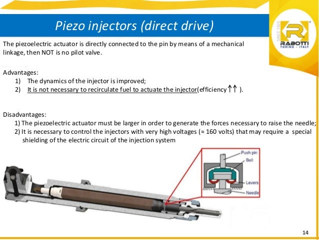

Re: Piezo ceramics as cutting head drivers?
Unfortunately also don't know exactly how they work. I once found out about them by the way, when I was looking for jetting valves for jet printing solder paste.
There are two varieties; the indirect one (with shorter piezo stack + chydraulic motion amplifier) and the direct one with a longer piezo stack (there is a mechanical lever here too, but maybe this vary from model or manufacturer). To power the direct ones, there is need for 160-200V and 5A(?) in peak.
Found some two images from https://www.slideshare.net/LucaNurchi/introduction-to-common-rail (slides 14 and 15).
I'm not sure if only Delphi produces direct models. The example model is probably Delphi 28254952.
I wonder how they sound (if they sound at all) after connecting to some PA amplifier (100V output, but it may not be enough).
