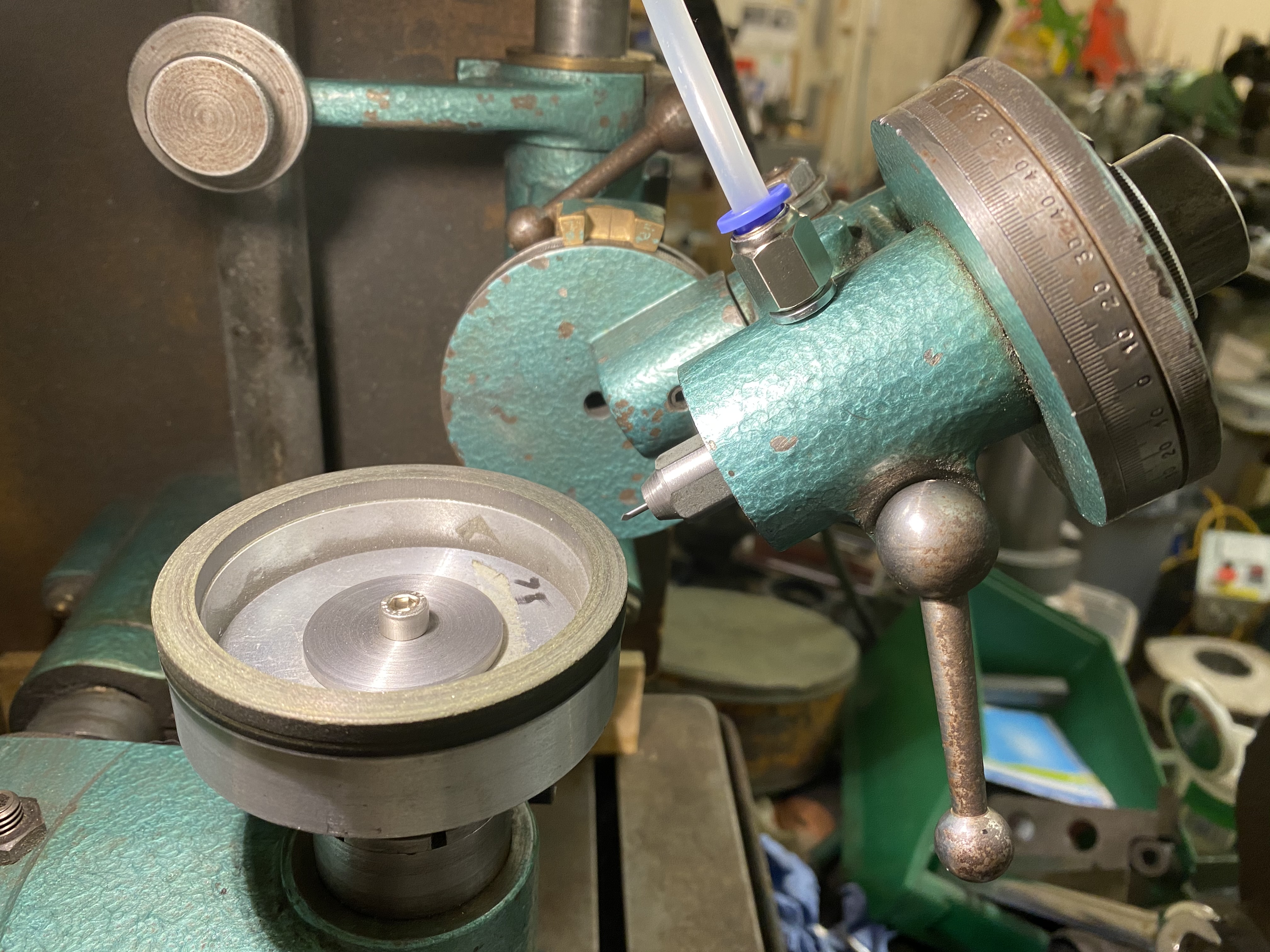

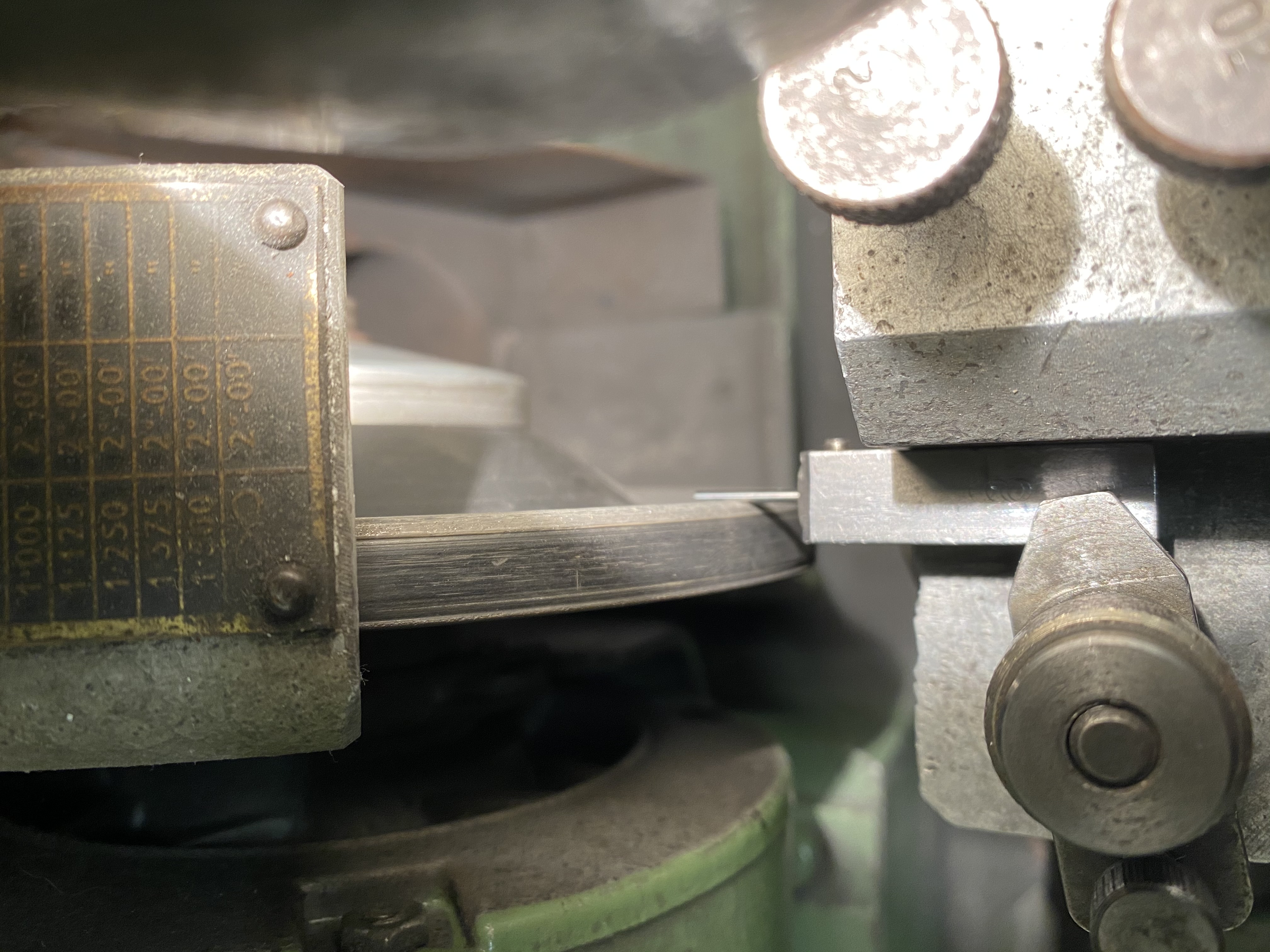

Hi All,

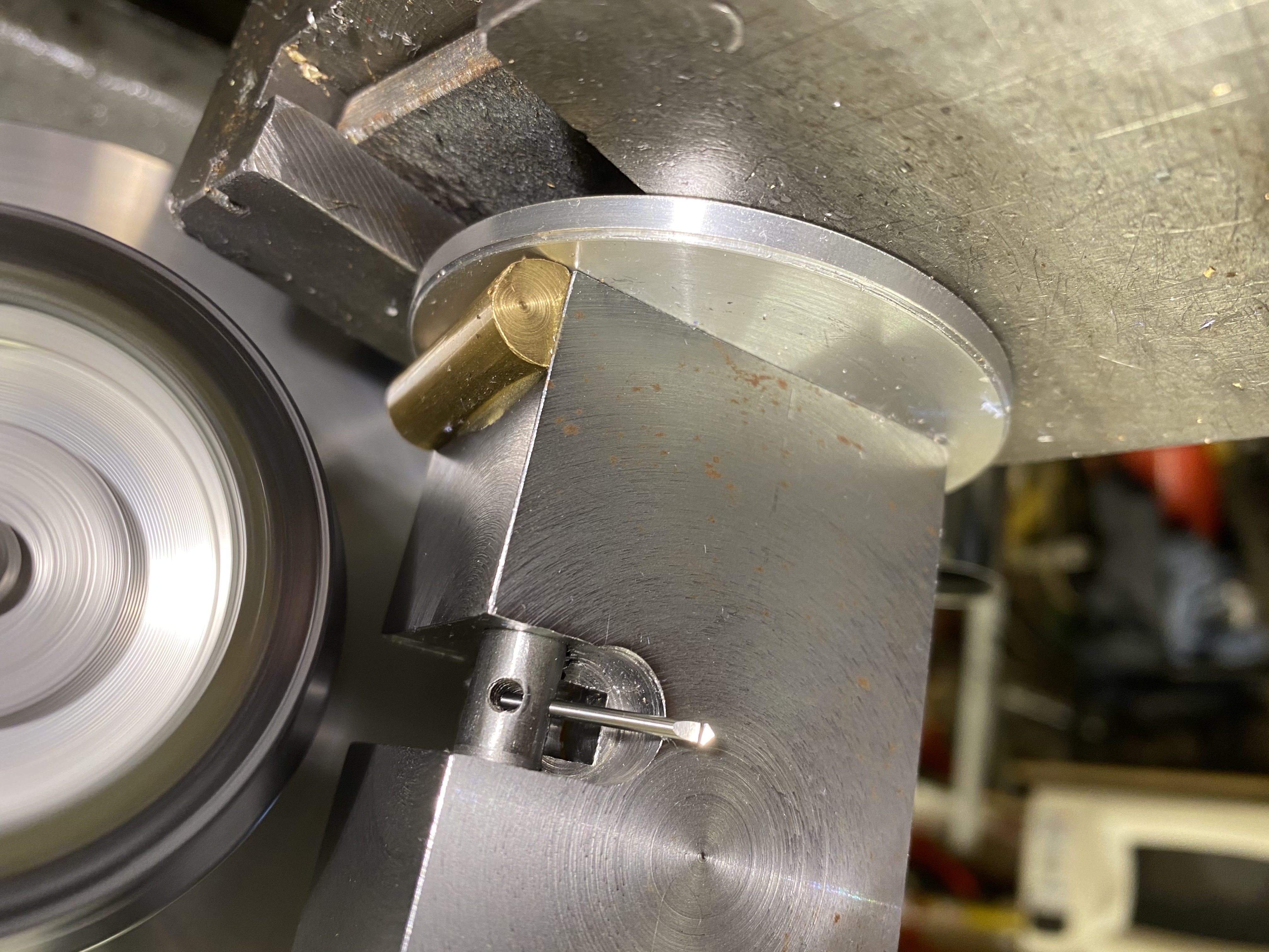

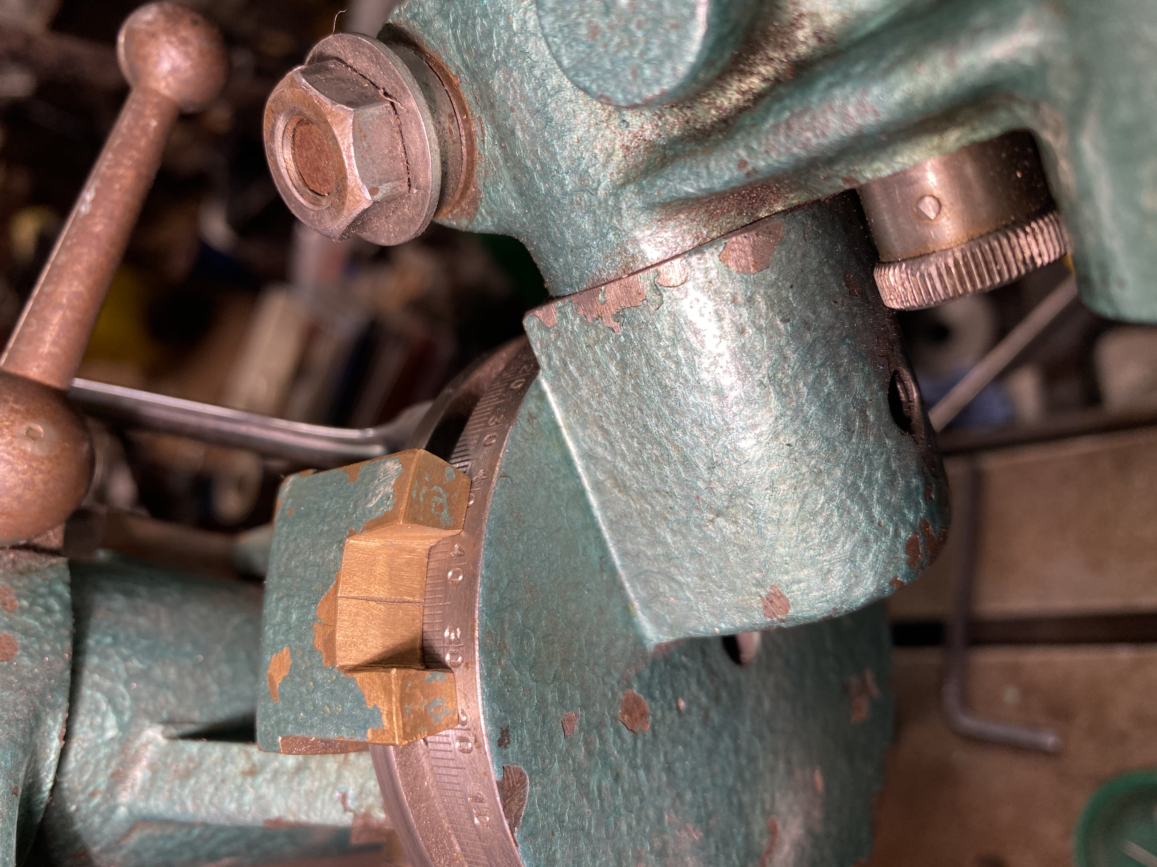

I used to make needles with a jig but you're limited to one geometry.
Now that I got used to using the tool & cutter grinder for making embossing cones I thought I'd use it for needles too.

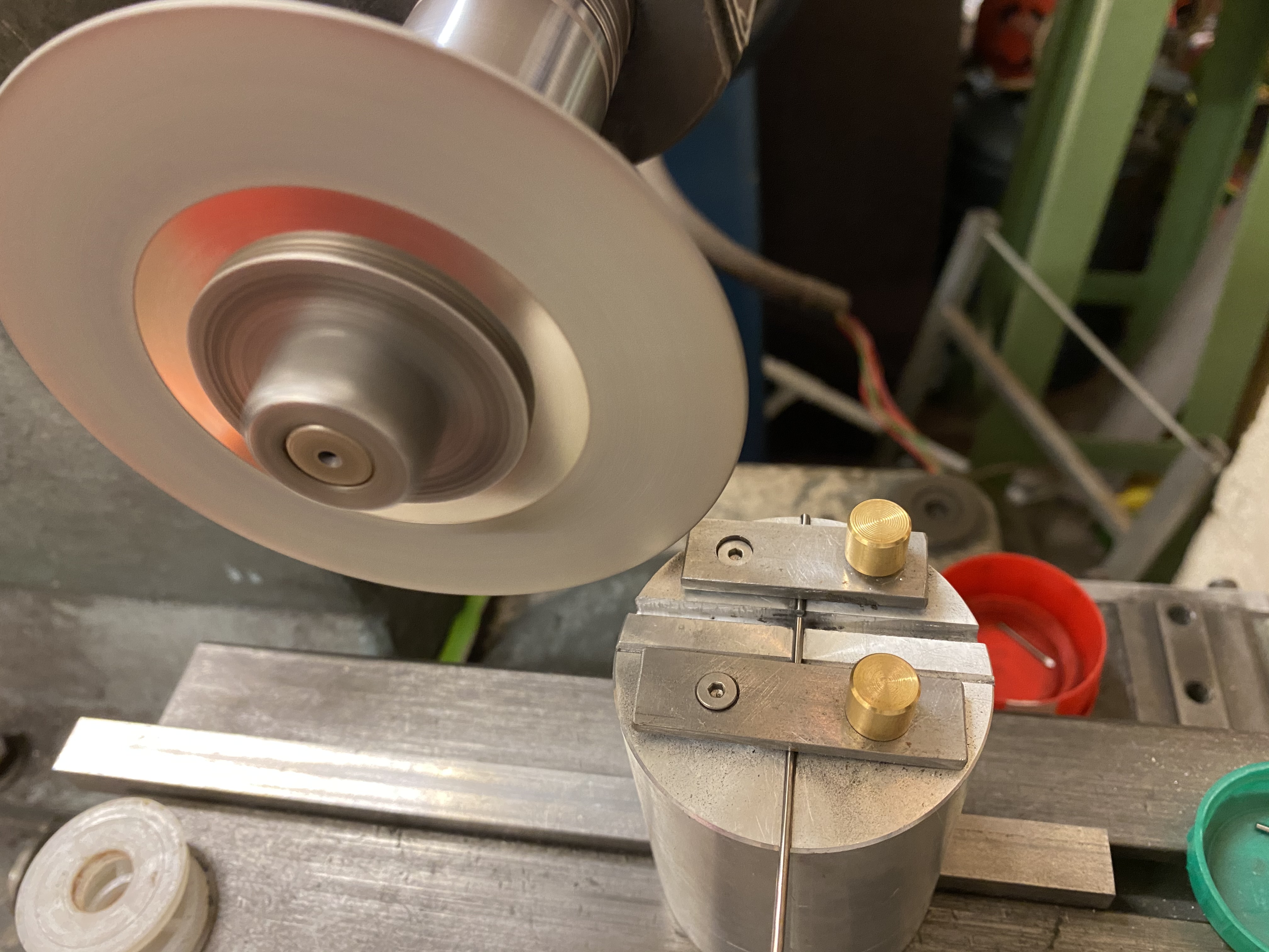

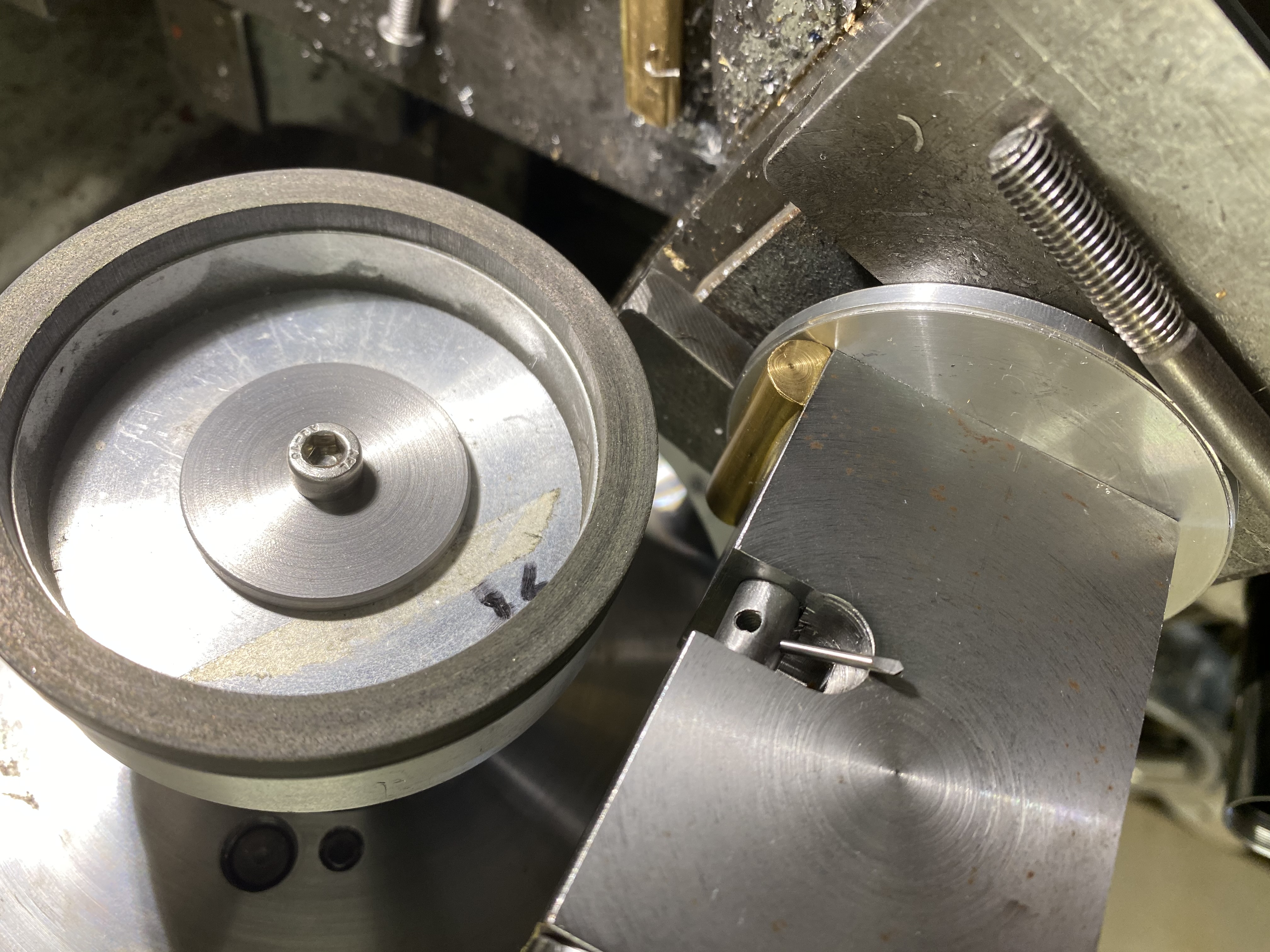

Step 1: Parting off on the Clarkson T&C grinder

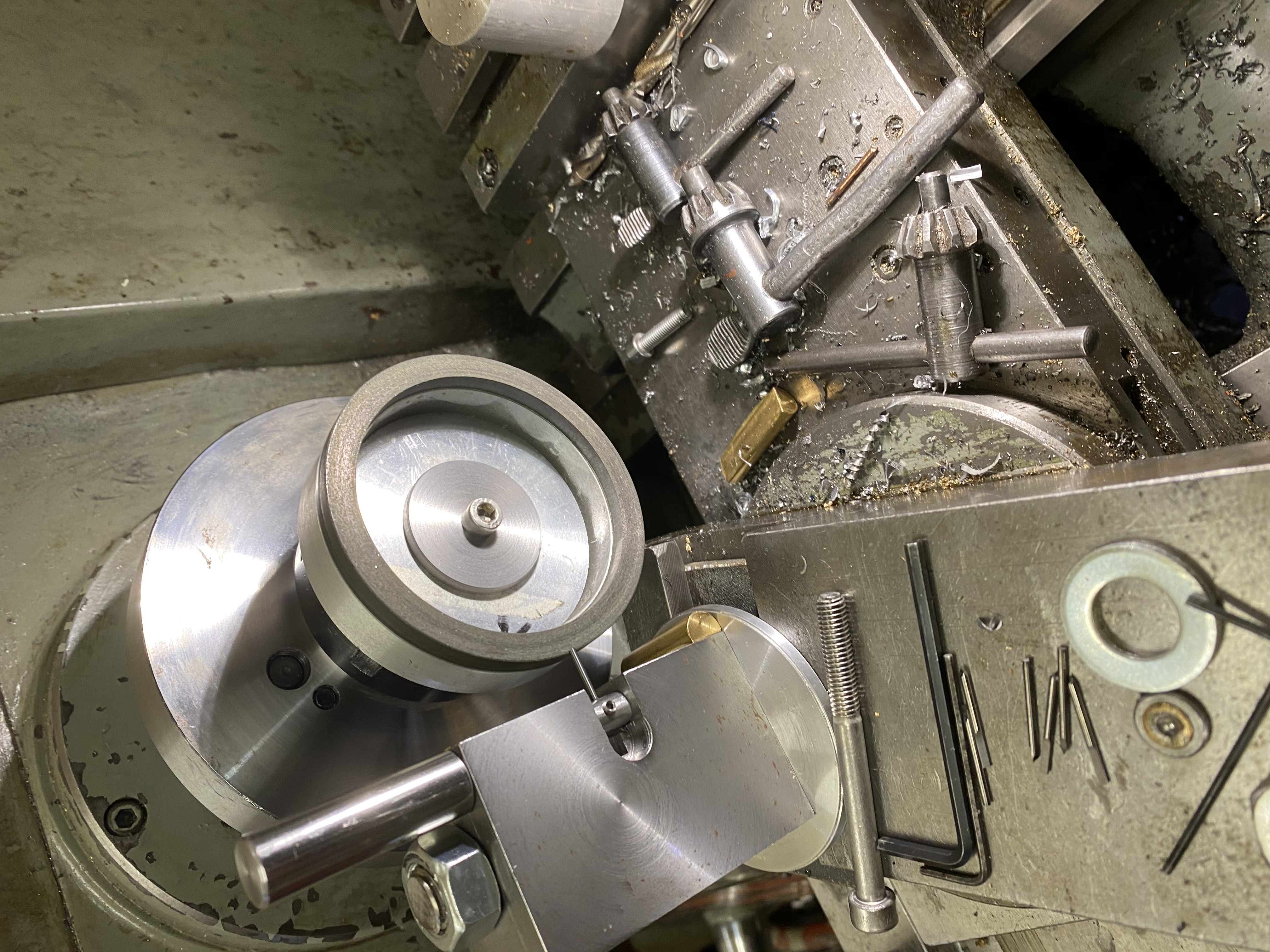

Step 2: Cutting the locating face on the Tiplap T&C grinder

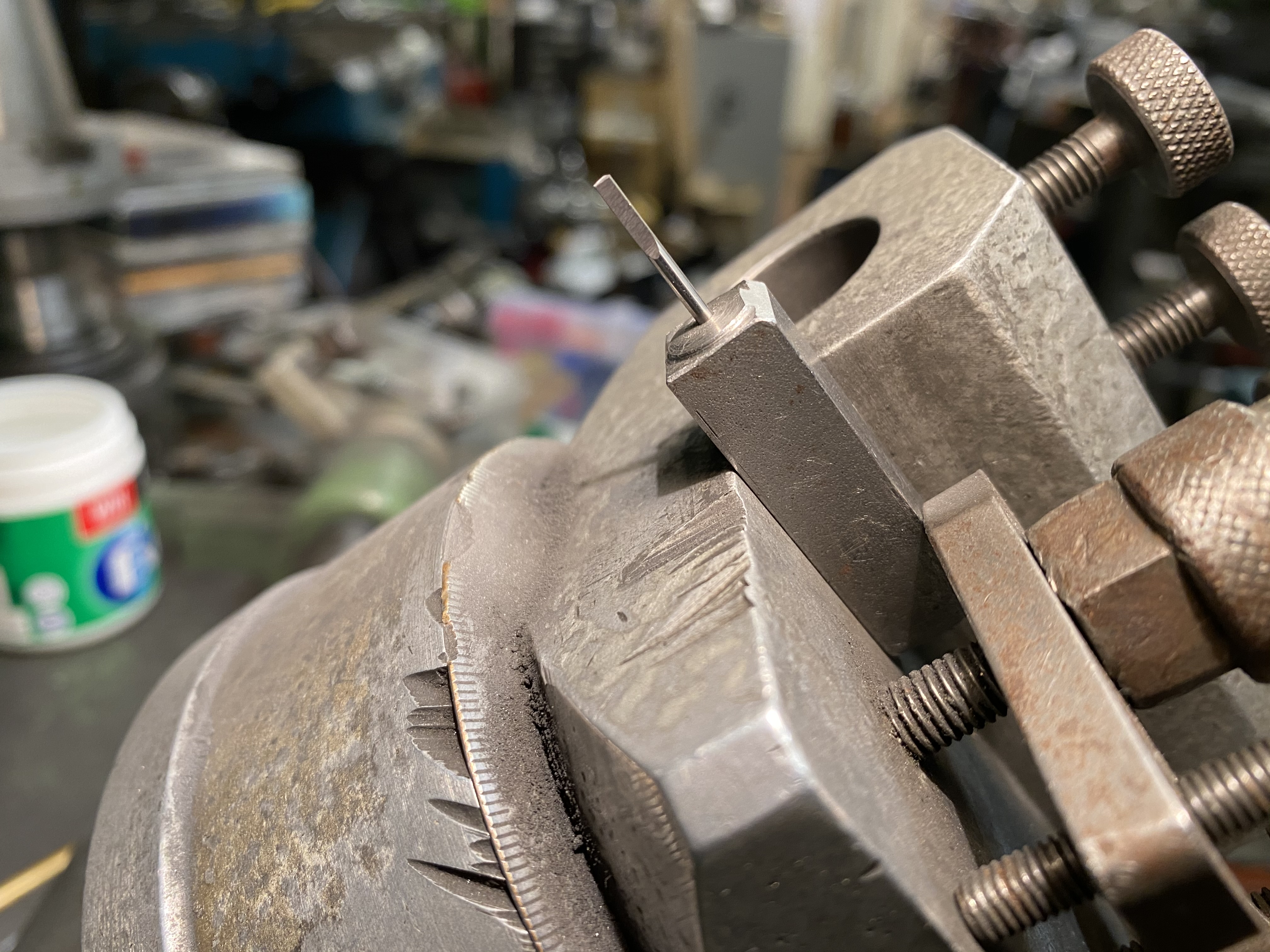

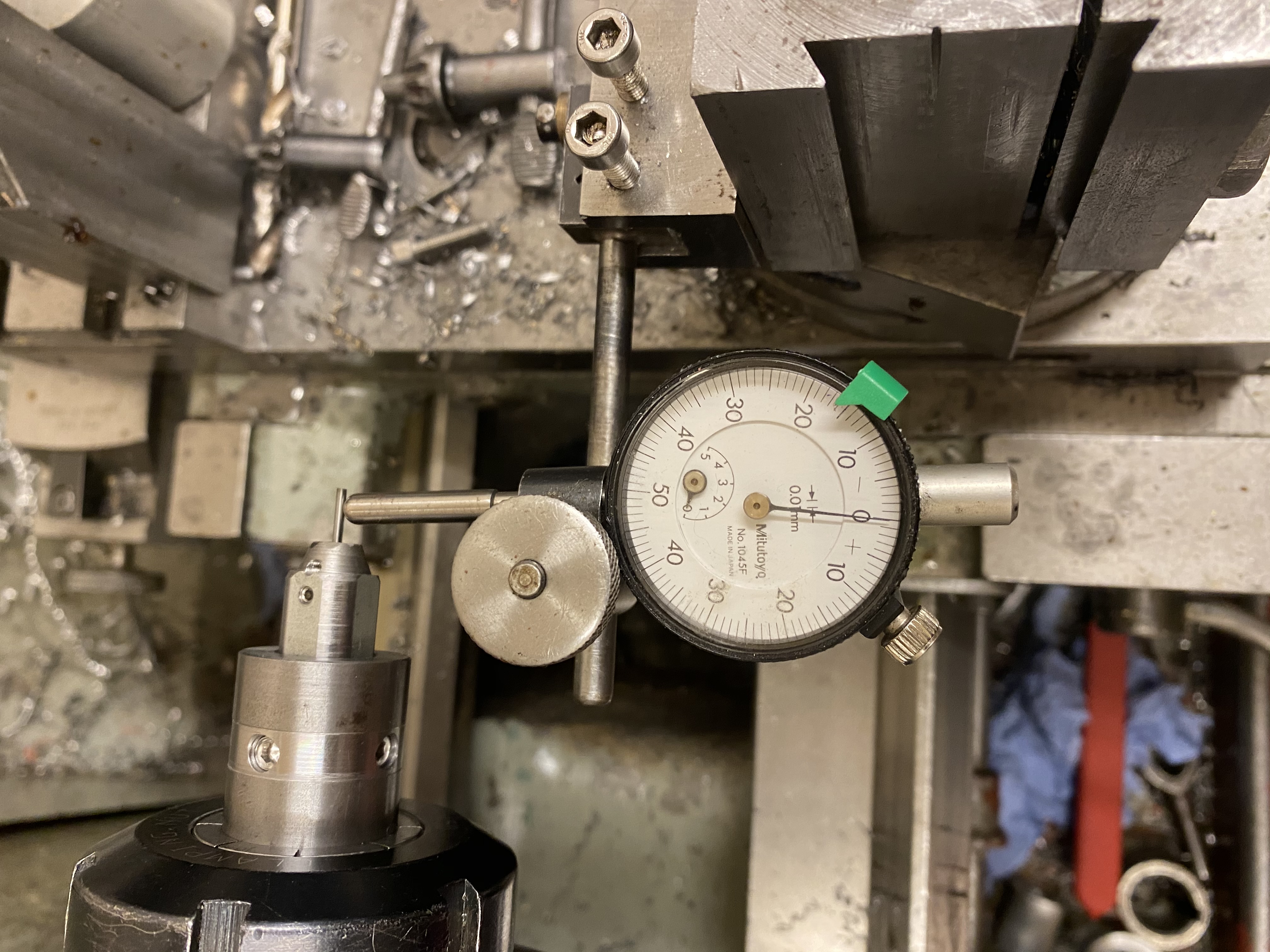

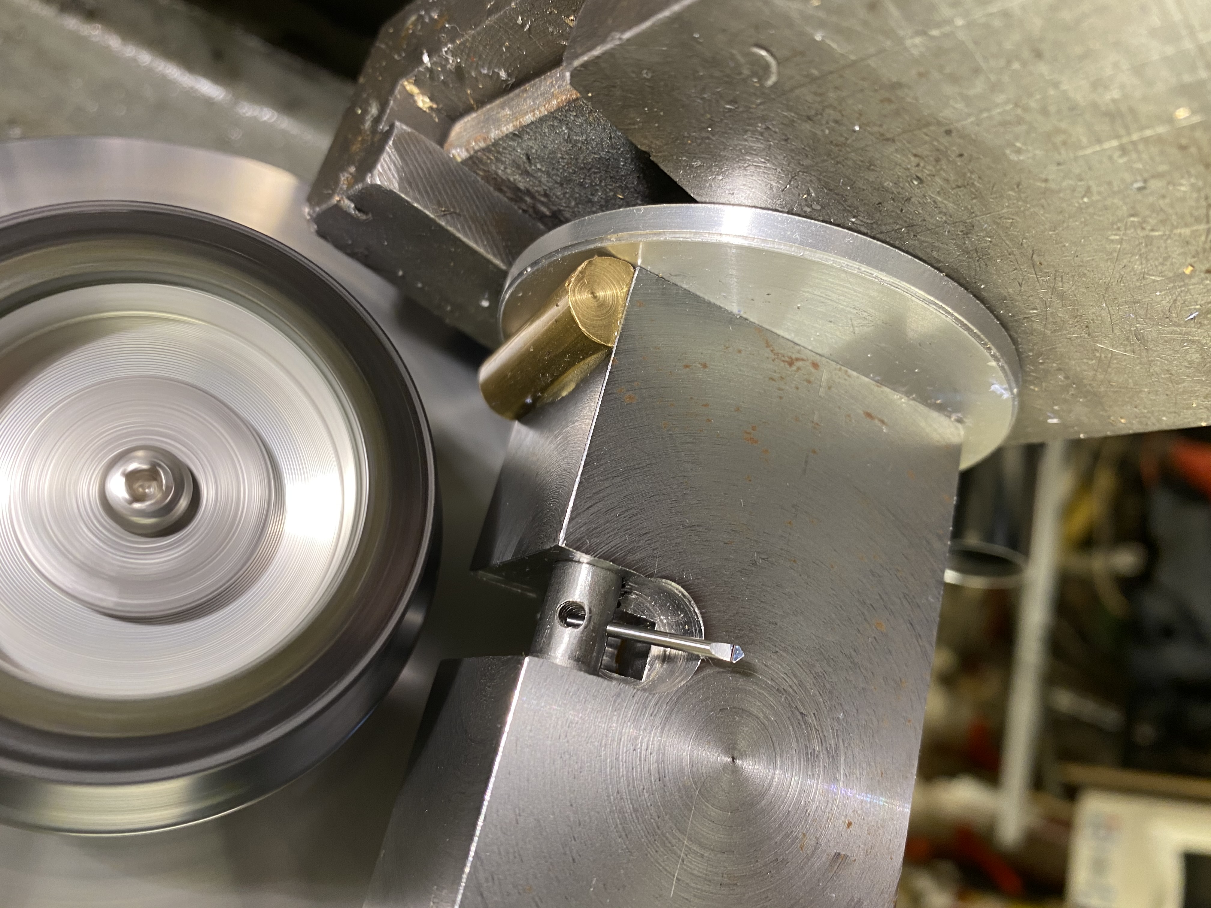

Step 3: Clocking the needle in the holder (Colchester Bantam lathe).

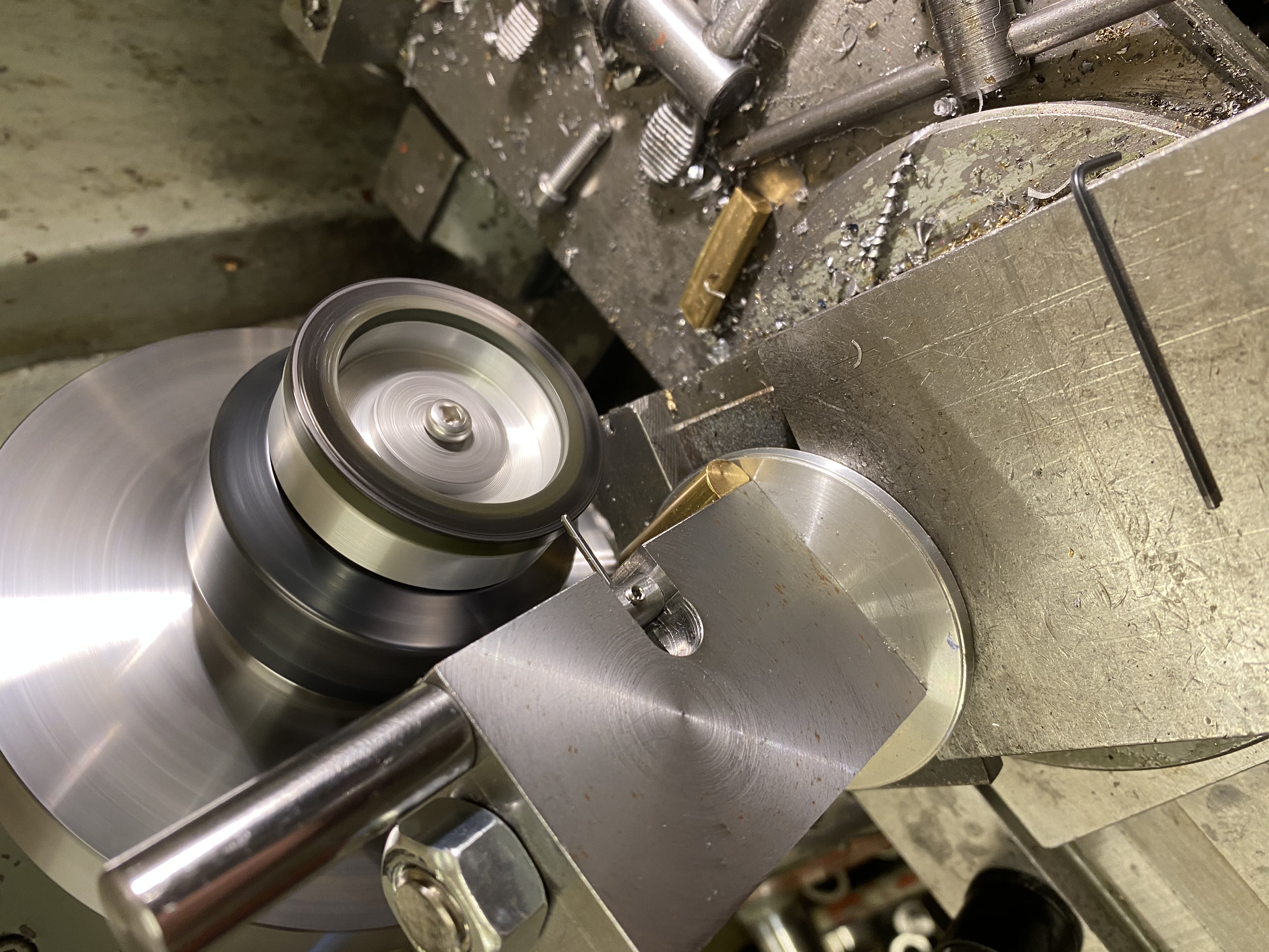

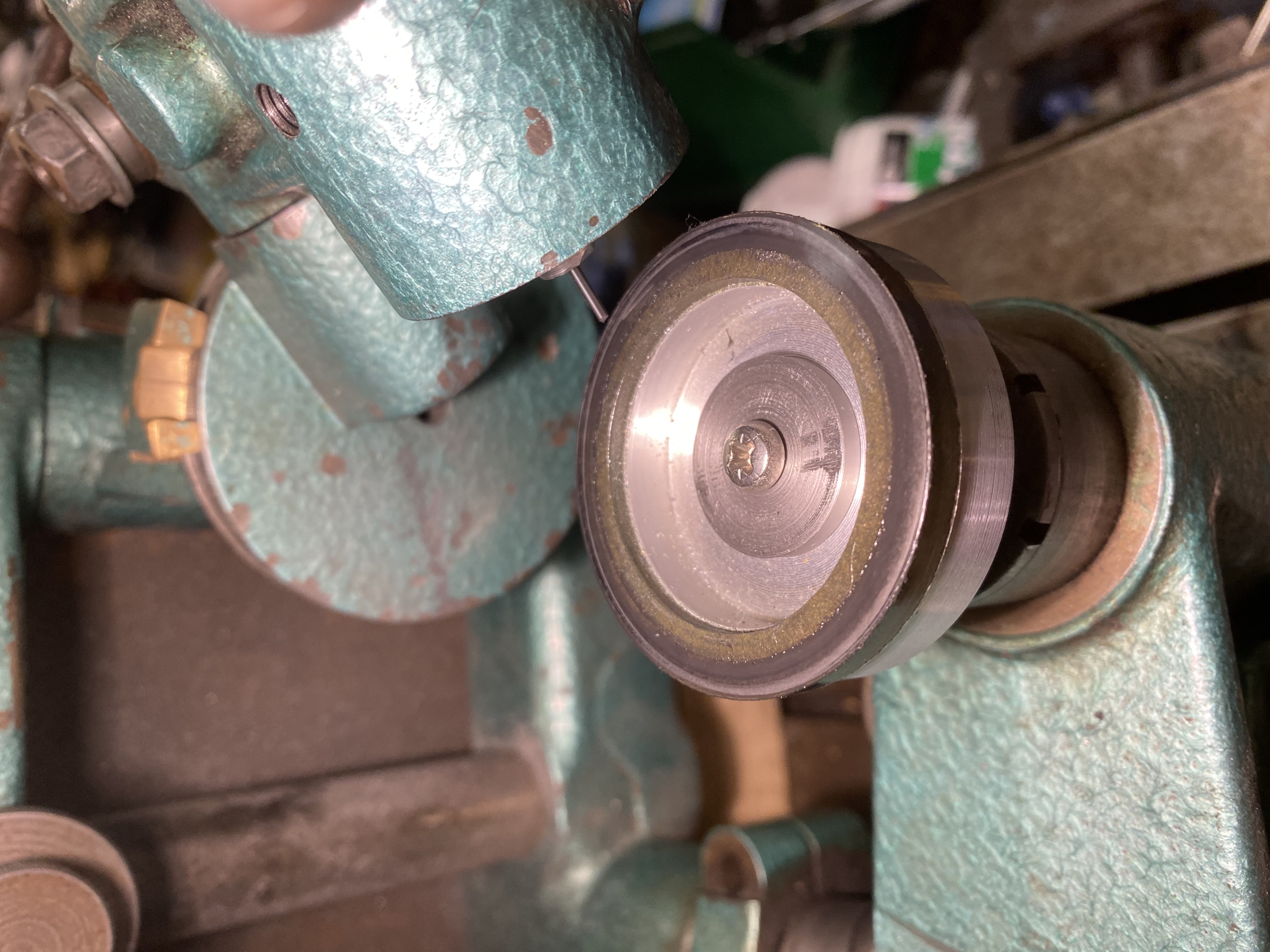

Step 4: Setting the face angle. Here to 35.5 degrees for a full angle of 71 degrees (Quorn T&C grinder).

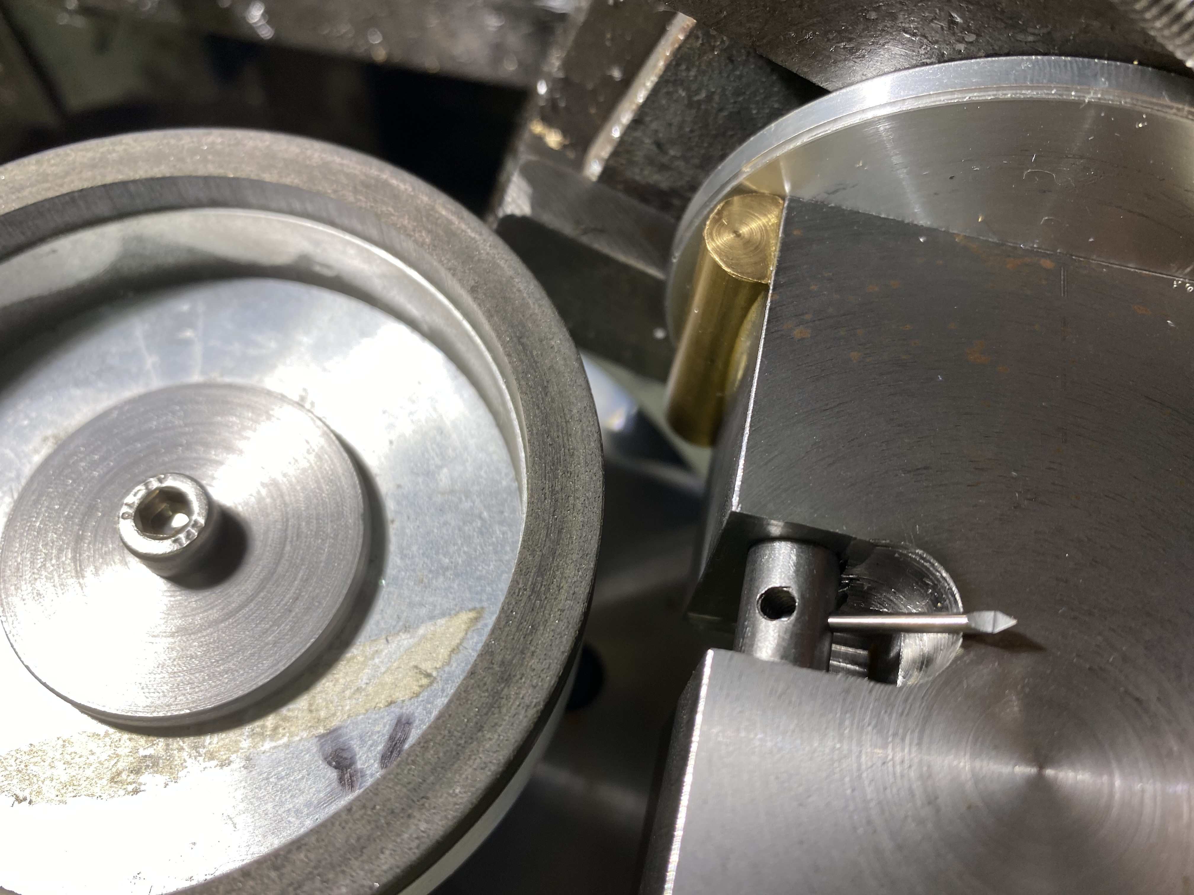

Step 5: Roughing the first side.
Step 6: Roughing the second side.

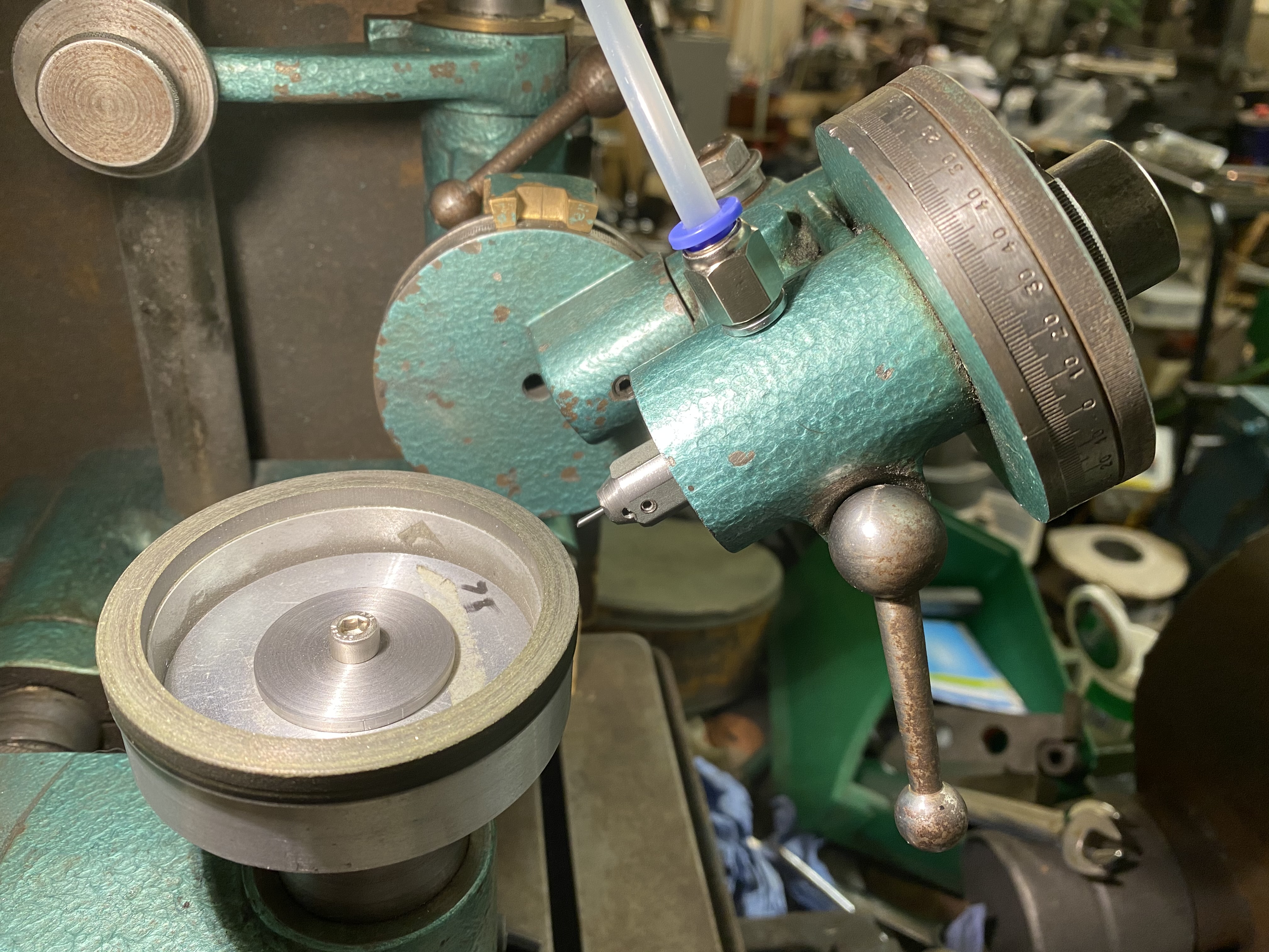

Step 7. Polishing the first side.
Step 8. Polishing the second side.
Step 9. Deburring the cutting face (Colchester Bantam lathe).
Step 10. Polishing the cutting face.
Upside... you can make anything. Downside... takes about 10X as long to do as with a jig. Just the visual inspections are time consuming.
Each cutting op needs 3 inspections per cut. One to check its roughly right. A second to check its going right & a third to see that it completed right. And that's if everything goes as planned. That's 24 visual inspections per needle.
Still... the results compared to what I was doing are in a totally different league.
I've got a lapping disk that I could charge with sub micron diamond paste for 'super finishing' but no point doing that till I know these actually work.
Just because they look good means nothing. They could look good & the geometry could be crap & they might not work at all.
We shall see I guess.
